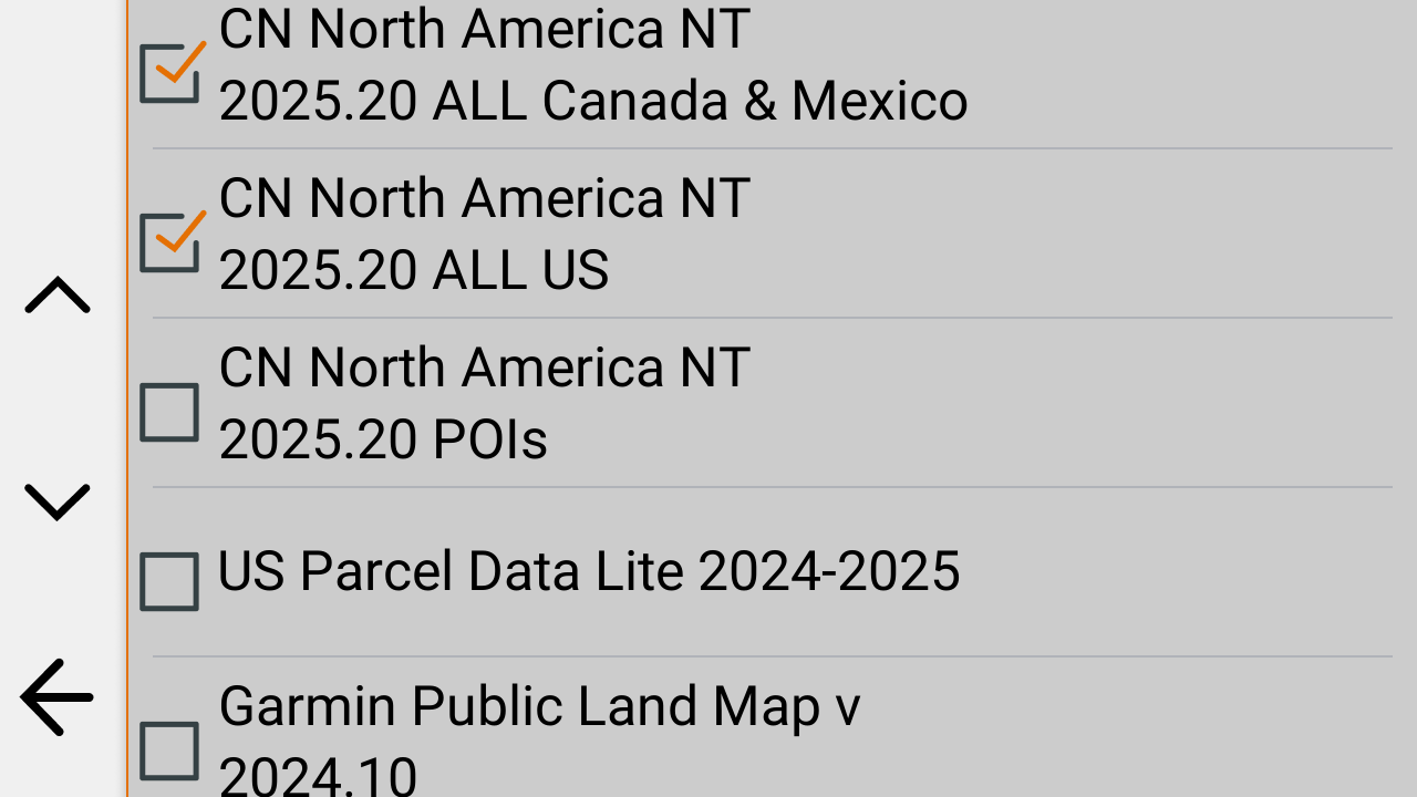

The map information should now be displayed. See the sample screenshot below:
Map list example tread 2
In your device's Map Manager menu, each currently loaded map can be selected or de-selected by touching the box to the left of a map name to add or remove a checkmark. Because a device can only display one map at a time, it is not advised to select a supplemental map like another country and the preloaded map at the same time.
If multiple maps are selected, the device will automatically deselect any supplemental maps once it is restarted, leaving only the preloaded map selected.
If you would like the device to use the supplemental map by default each time it is powered on, navigate to the Map Manager menu, and ensure that only the desired supplemental map is selected. The device will not switch to the preloaded map upon restarting, as long as only one map is active.

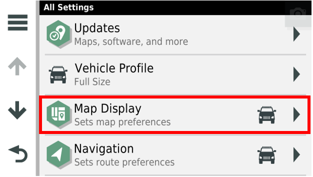

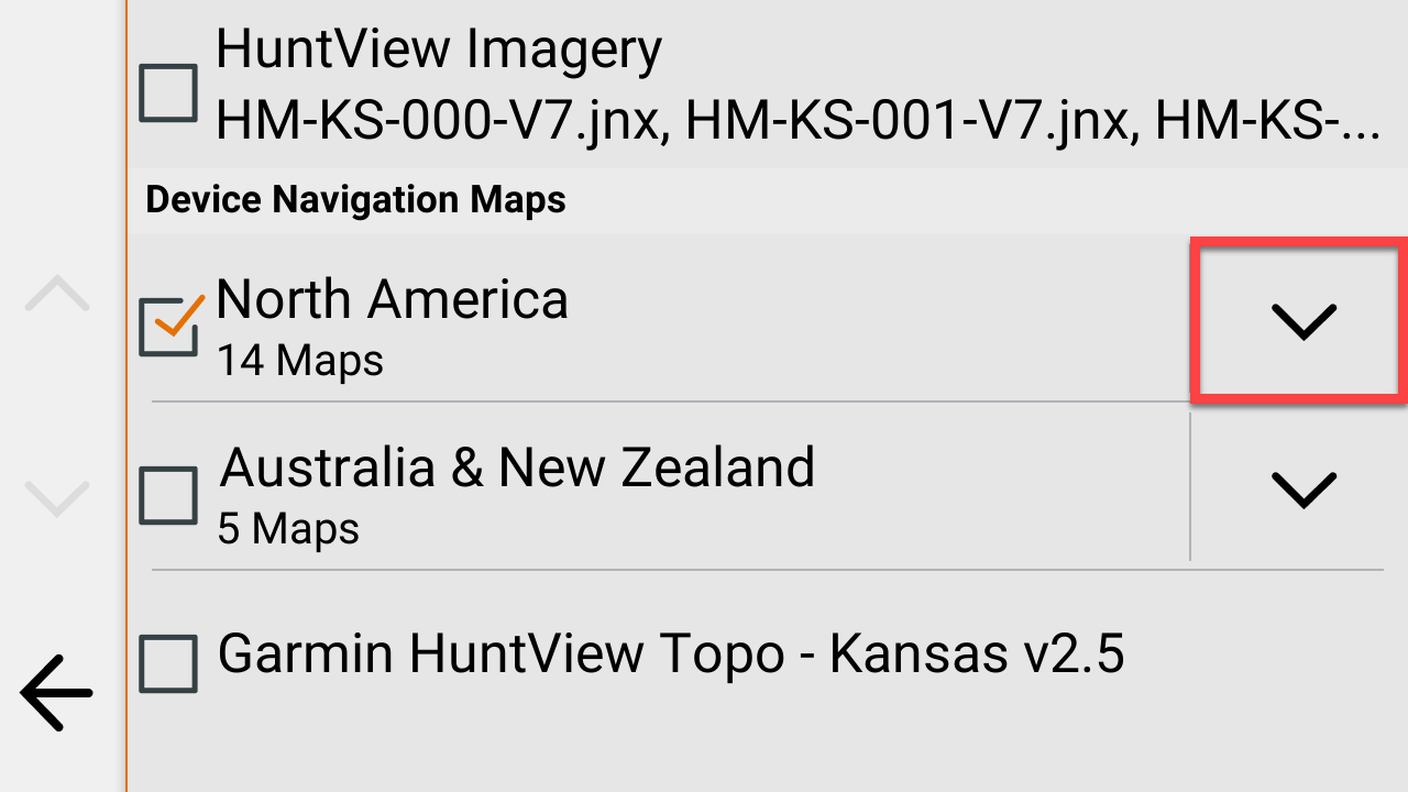

Tread® - Overland Edition | Tread® XL - Overland Edition | Tread® - SxS Edition | Arctic Cat G8 Display | Kawasaki RIDGE® 8" Tread® Display GPS navigators:
1. Touch Settings.
2. Touch Map Display.
3. Scroll down and touch Map Manager.
4. Touch the arrow next to Manage Device Maps.
  • Skip this step on some devices
5. Touch the down arrow to expand the map list under the desired mapping.

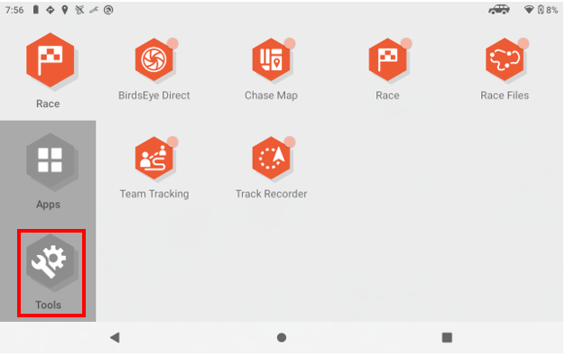

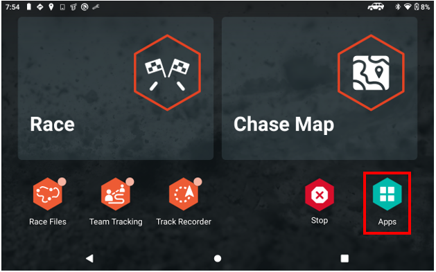

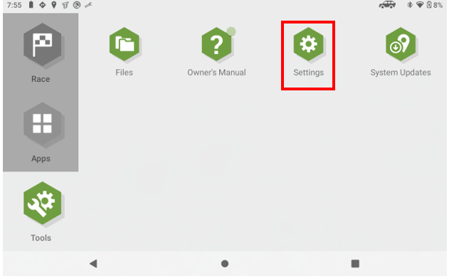

Tread® XL - Baja Chase Edition | Tread® XL - Baja Race Edition GPS navigators:
1. Touch Apps.
2. Touch Tools.
3. Touch Settings.
4. Touch Map Display.
5. Touch Map Manager.
6. Select Manage Device Maps.
7. Touch the down arrow to expand the map list under the desired mapping.

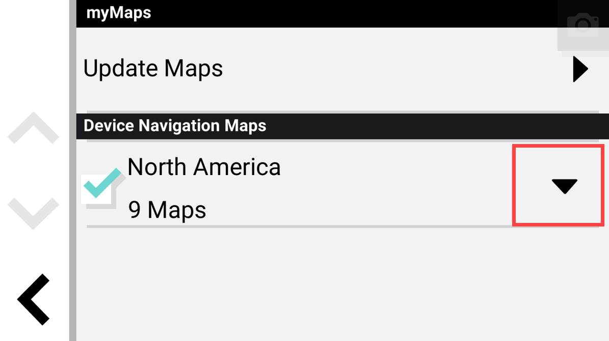

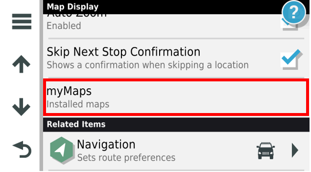

Tread® | Tread® - Base Edition | Tread® Textron GPS Navigators:
1. Touch Settings.
3. Scroll down and touch myMaps.
4. Touch the down arrow to expand the map list under the desired mapping.
In your device's myMaps menu, each currently loaded map can be selected or de-selected by touching the box to the left of a map name to add or remove a checkmark. Because a device can only display one map at a time, it is not advised to select a supplemental map like another country and the preloaded map at the same time.
If you would like the device to use the supplemental map by default each time it is powered on, navigate to the myMaps menu, and ensure that only the desired supplemental map is selected. The device will not switch to the preloaded map upon restarting, as long as only one map is active.
