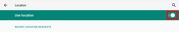

To simulate a route, you will need to turn the Location settings to Off on your device.
To Turn the Location Off on Your Device:
  1. Touch Apps
  2. Touch Tools
  3. Touch Settings
  4. Touch Personal
  5. Touch Location
  6. Touch the switch icon  in the top-right corner of the screen to turn it  gray, which will turn Location off
You may now use the device to simulate a route to a given destination.
