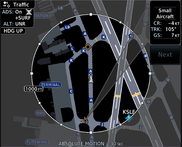

Slow-moving (less than 20 knots) 1090ES ADS-B and ADS-R surface targets may erroneously appear as directional. Figure 1 shows an example traffic display with both slow-moving directional and non-directional surface traffic. The selected surface target is erroneously shown with a directional symbol while the surface target near the top is correctly shown with a non-directional symbol (diamond).

AV_KM1699039
