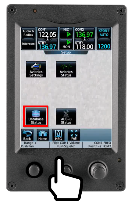

How do I switch between database regions on an integrated flight deck, such as on the G3000?

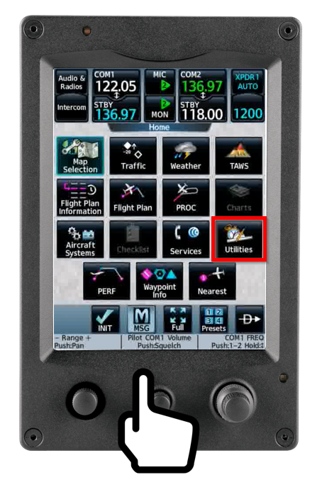

  1. On the G3000® flight deck Garmin Touch Controller (GTC), navigate to HOME, then select UTILITIES:

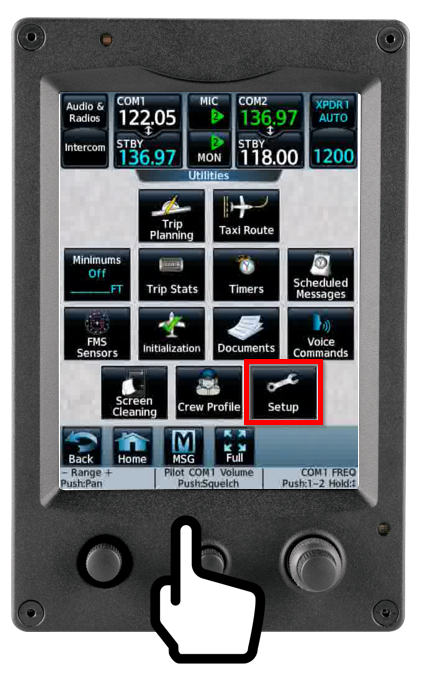

  2. Next, select SETUP:

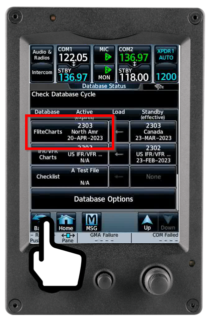

  3. Next, select DATABASE STATUS:

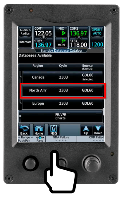

  4. Next, select the Standby Column of the database where you wish to select a different region.  In this example, we are selecting the region for FliteCharts® database.

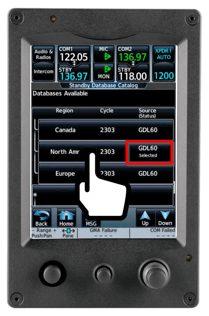

  5. Next, select the desired REGION and confirm the selection by selecting OK on the pop-up:
  6. You will see the word "Selected" on the region the system is set to use:
  7. Ensure the selected region is showing in the "Active" column:

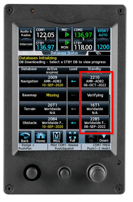

According to FlyGarmin.com, the GDL 60 says that it has downloaded all current charts, but when I go to my aircraft, I'm still seeing old chart versions.  What is going on?
 Verify the correct databases are loaded. From the GTC, go to:
  1. Utilities
  2. Setup
  3. Database Status
Confirm that the Effective Date is past the Current (today's) Date, and that a database update is not currently in progress.  Finally, confirm that there aren't any database SD cards loaded in the displays, as the system will prioritize the SD card over the GDL 60.
