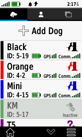

Dog List / Tracked Device List
The Alpha 200 handheld has a completely redesigned Dog List; it is now called the Tracked Device List. The Tracked Device List includes not only the Dog List, but also the Tracked Handhelds/Contacts List, and the Group Management control:
  • Easily see the radio status of all your tracked devices:
    • ID number
    • Battery level
    • Radio Communication and GPS signal strength
  • Tap any item for its Info Page for deeper menu controls
    • The ID sharing functions and codes
    • Adjust the collar beacon light
    • Activate or deactivate an individual dog or handheld
    • Assign the device to a different group
Alpha 200i doglist
