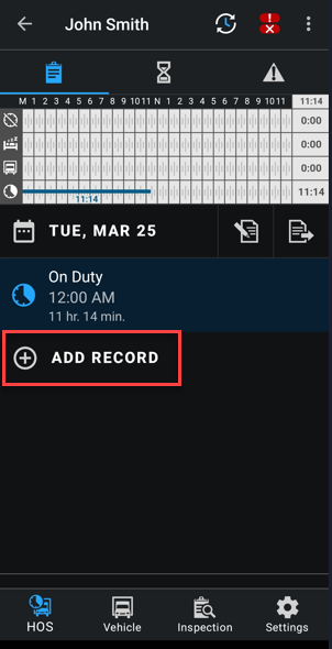

1. Open the Garmin eLog app
2. Sign in to the Driver Profile
3. Touch Add Record
Android Add Record

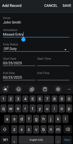

4. Fill in the necessary information
Annotation:
Android Annotation

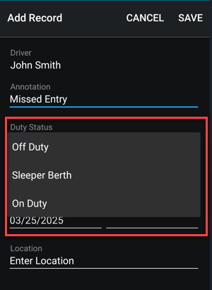

Duty Status:
Android Duty Status

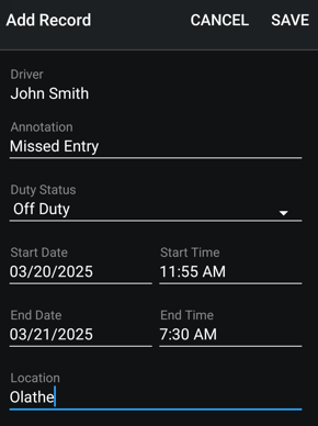

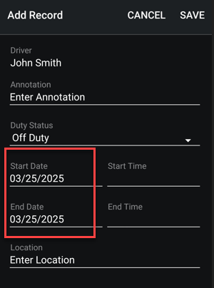

Start and End Date

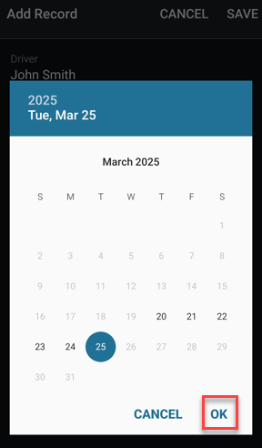

1. Select the Start or End Date
Android 1
2. Select the date on the calendar, then tap OK
Android Calendar OK

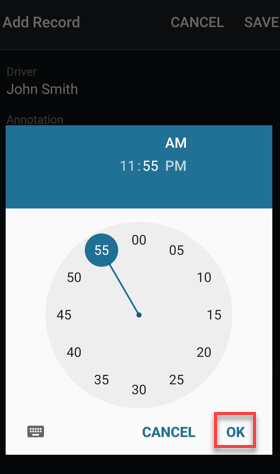

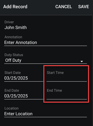

Start Time / End Time:
1. Select the time by the corresponding start or end date
Android Start Time End Time
2. Select the time on the clock, then tap OK
Android Clock
Location:
Android location

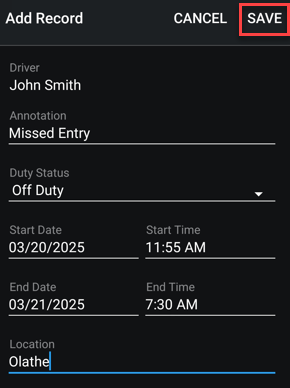

5. After filling in the information, touch Save
Android Save
The record will now be added.

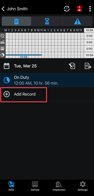

3. Touch Add Record
iOS add record 1

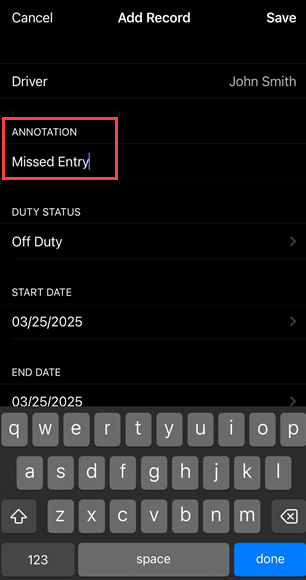

Annotation:
iOS Annotation Red box

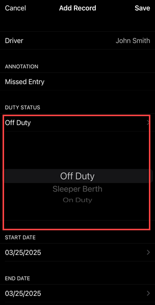

Duty Status:
iOS Duty Status

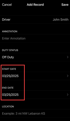

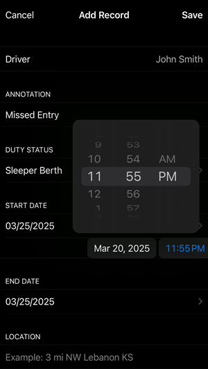

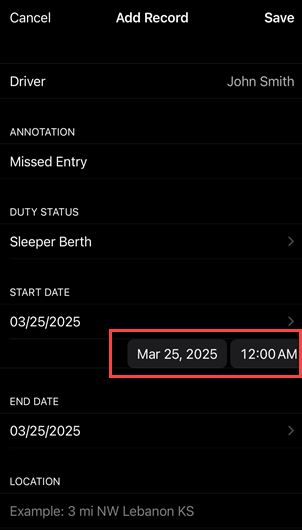

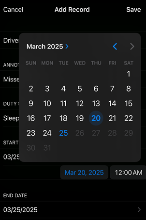

Start Date / End Date:
1. Select the Start or End Date to access the date/time.
iOS Start End Date
2. Select the Date or Time to make changes.
iOS Date Time 1
    • Select the date on the calendar:
iOS Calendar
    • Select the time on the clock:
iOS Clock.

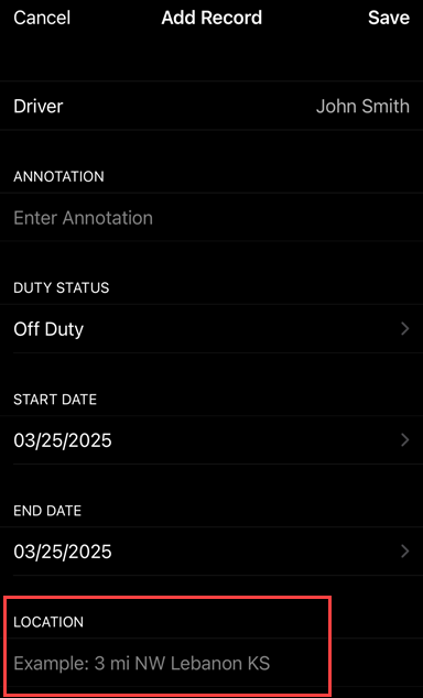

Location:
iOS Location 1

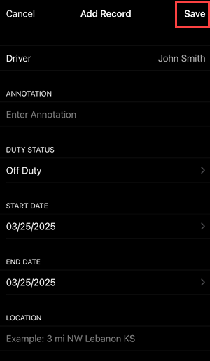

Add Record Save Selections
