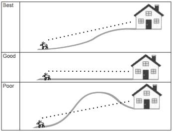

  • Large objects such as a shed, metal structure, or car as they can reflect radio waves (See images below)
  • Hills or slopes in the ground can also interfere if they block line of sight (See image below)
