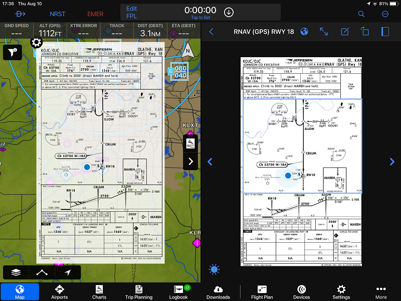

  3.  Jeppesen Terminal Charts can also be viewed from the Map page in split screen mode.
  4. Once you have a chart selected from Split Screen, you can select Map to view the selected Chart overlaid on the Map.
    • Chart Overlay 1
    • Chart Overlay 2
  5. To remove the Chart from the Map, select the Settings gear in the top left of the Chart, and then select Remove.

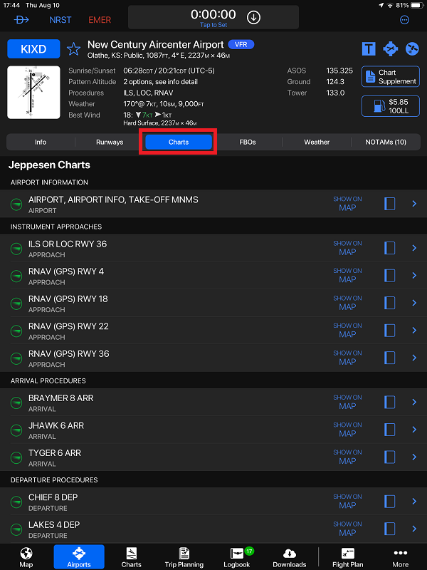

  6. Your Jeppesen Terminal Charts can also be viewed from the Airports page after selecting charts:
    • Airport Page Charts
