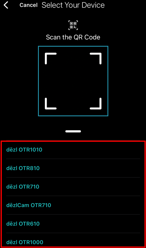

NOTE: It is recommended to use the QR code when available for pairing. This is usually shown during the device setup.

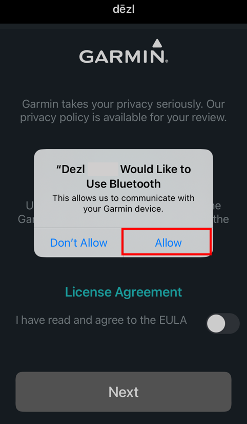

6. Open the  dēzl App and select Allow

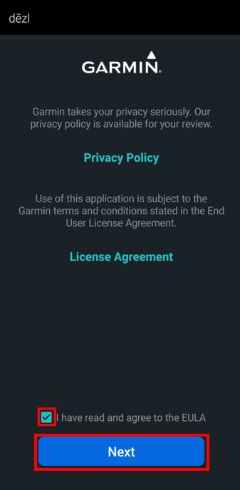

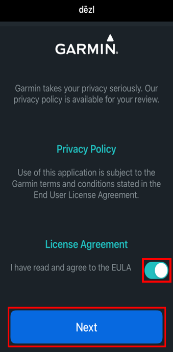

7. Accept the End User License Agreement and touch Next

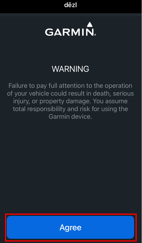

 8. Touch Agree

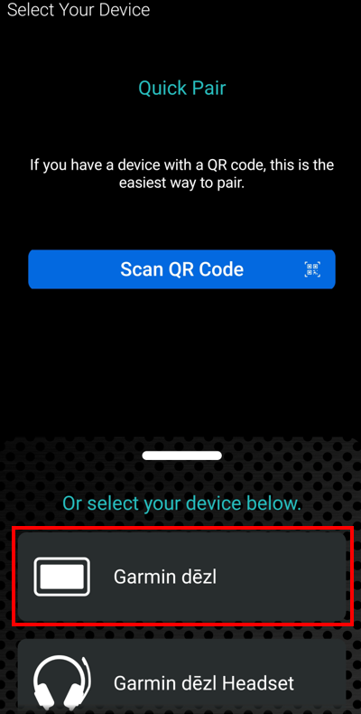

9. Scroll down and select your Garmin dēzl model from the list

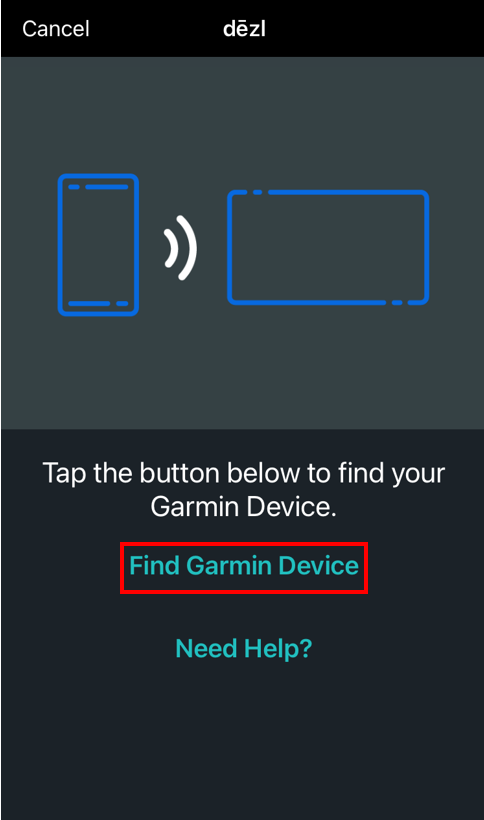

10. Touch Find Garmin Device

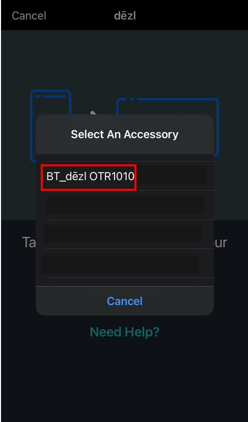

11. Touch the name of the Garmin device from the list of compatible Bluetooth devices in the area

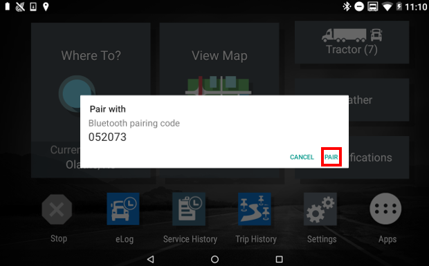

12. Touch Pair, if prompted on the Garmin device
13. Touch Pair on the phone, if prompted

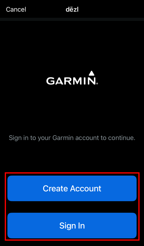

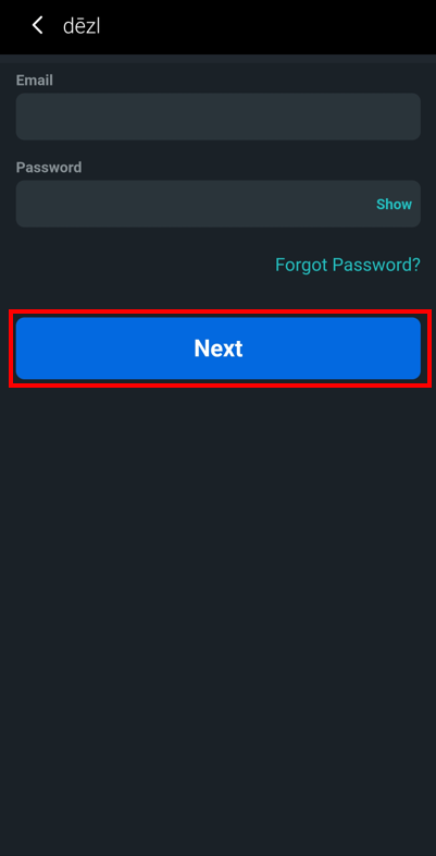

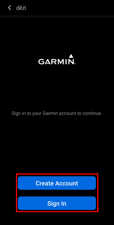

15. Touch Sign In. If you don't have an account touch Create Account
  • If you selected Create Account, enter your name, email address, retype your email address, enter your password, then select Next

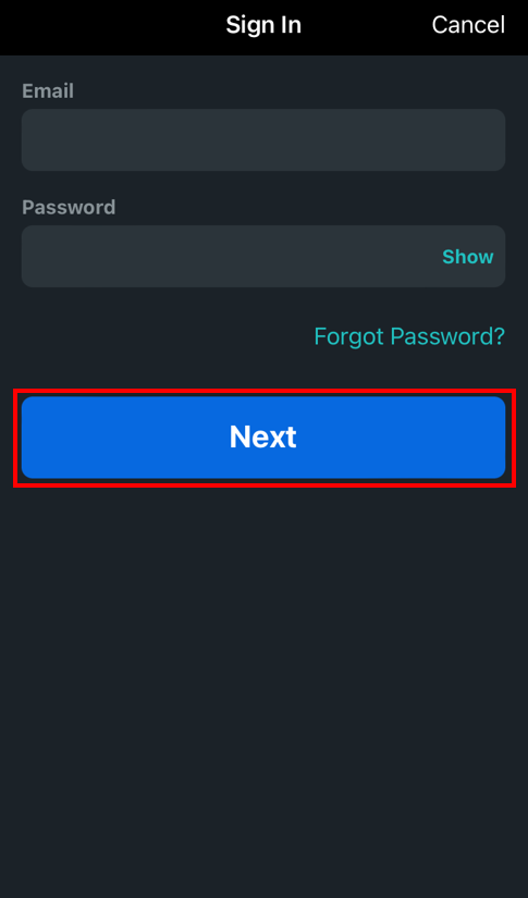

16. Enter your email and password and touch Next

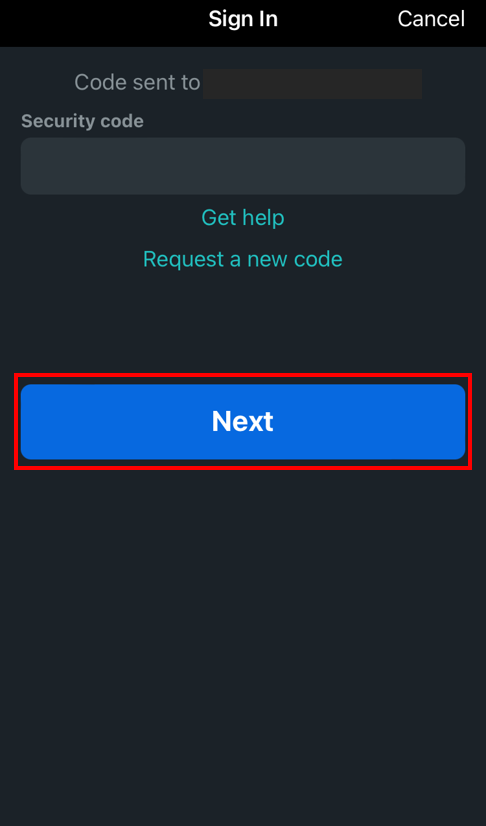

17. Enter the security code sent to your email address or phone number then touch Next
  • Skip this step if the code is not requested
18. Follow the on-screen prompts in the app

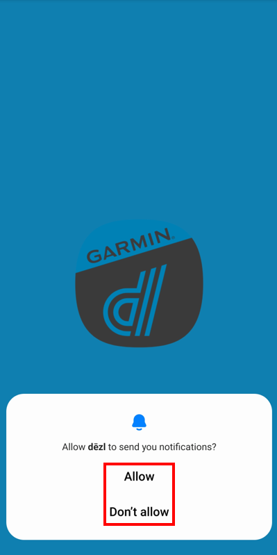

 6. Open the  dēzl App and touch Allow to allow the dezl app to send notifications
  • Touch Don't Allow to deny the dēzl App to send notifications to your phone

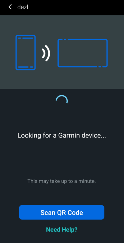

 9. Touch Garmin dēzl
10. The app will begin searching for the device

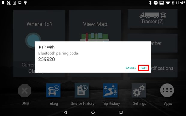

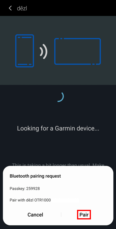

11. Touch Pair on the Garmin device
12. Touch Pair

14. Touch Sign In, if you don't have an account touch Create Account
  • If you selected Create Account enter your name, email address, retype your email address, enter your password, then select Next
15. Enter your email and password and touch Next

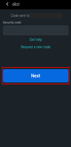

16. Enter the security code sent to your email address or phone number then touch Next
