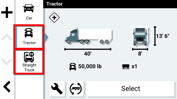

To Open or Edit the Vehicle Profile:

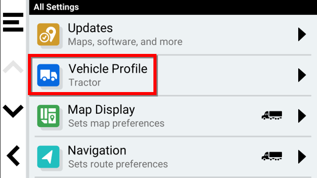

1. Touch Settings
2. Touch Vehicle Profile
3. Select the profile

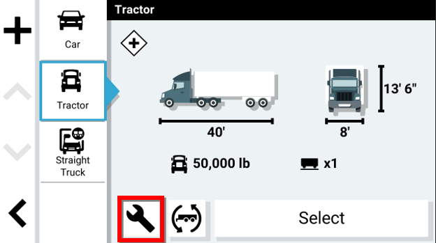

4. Touch the wrench icon
You can View/Edit the Following Fields From This Screen:
