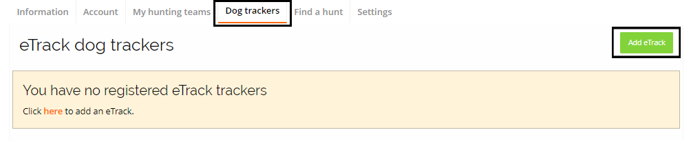

- Go to Profile in the top right corner.
- Then click on the "Dog trackers" tab and then select Add eTrack.

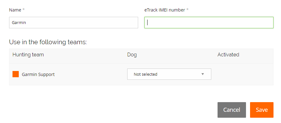

- Then enter the desired name for the tracker/dog followed by the IMEI number for the tracker. This is written on the tracker or on the original box that the tracker came in. Also click the boxes for each hunting team that you want the tracker should be visible for.

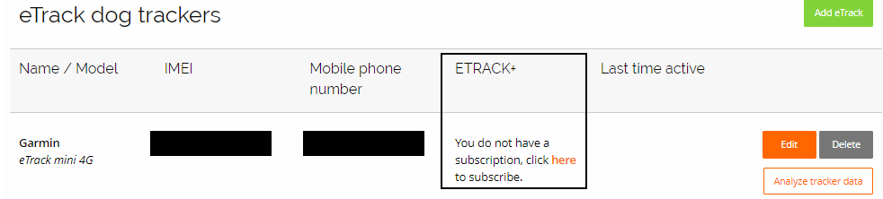

- Now that the track is added to your account, you can subscribe to an ETRACK+ subscription under the ETRACK+ column.
- Then enter the desired name for the tracker/dog followed by the IMEI number for the tracker. This is written on the tracker or on the original box that the tracker came in. Also click the boxes for each huting team that you want the tracker should be visable for.

- Check that the correct IMEI number is entered in your account and that there is an active subscription.
- Under Profile > Dog Trackers, ensure that the IMEI matches what is written on the back of the tracker. And that the date under ETRACK+ is valid.
