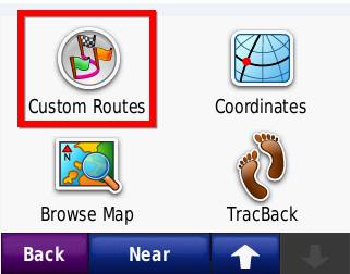

2. Touch Custom Routes

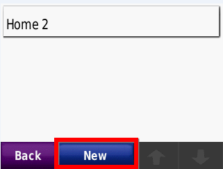

3. If no previous routes have been created, touch Yes when the prompt appears asking if you'd like to create one. If previous routes have already been created, touch New

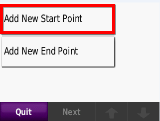

4. Touch Add New Start Point. (Note that the Start Point is not necessarily the point from where you'll be leaving. The Start Point will be the first point you would like to travel to).

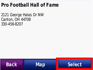

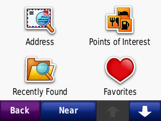

5. Use the various search functions to find and touch the desired starting point

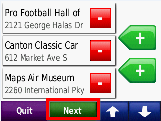

6. Touch Select

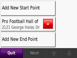

7. Touch Add New Start Point or Add New End Point to add a second point
8. Follow steps 5 and 6 to locate and add the second point
9. Add up to 200 total points by touching Add New Start PointAdd New End Point or
  • Touching  will add a destination in between the two points indicated
  • Remove points by touching  next to the point(s) you want to remove
10. Touch Next once all desired points have been added. The device will calculate the route and display it on the map preview screen
11. Touch Save to finish or touch Back to return and add/remove more points
