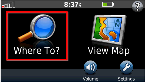

1. Touch Where to?
50 where to

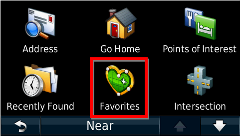

2. Touch Favorites
50 faves

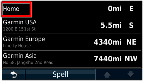

3. Touch the favorite named Home

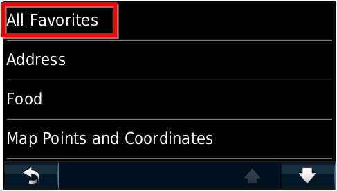

    • Some devices may display your favorites in categories. Touch All Favorites or All Saved Locations in order to locate the Home favorite on the list.
 50 all faves

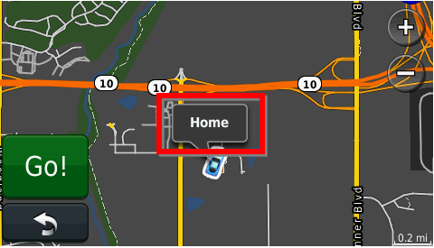

4. Touch the "bubble" pointing at Home (usually says "Press for More")
 50 bubble

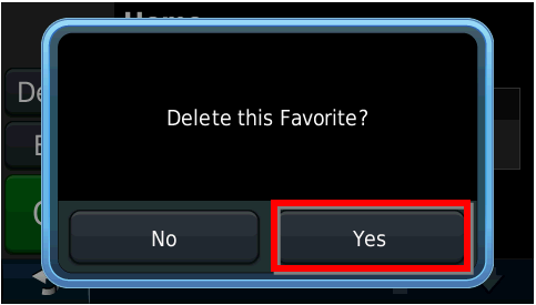

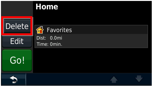

5. Touch Delete and confirm by touching Yes
 50 delete
50 yes delete

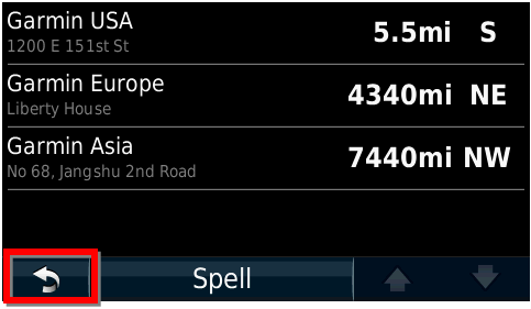

6. Touch the back button to exit the favorites list
 50 back button

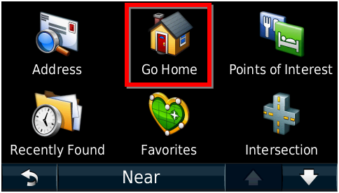

7. Touch Go Home
 50 go home
8. Select an option for setting the new home location
The home location has now been changed. Repeat these steps as needed.
